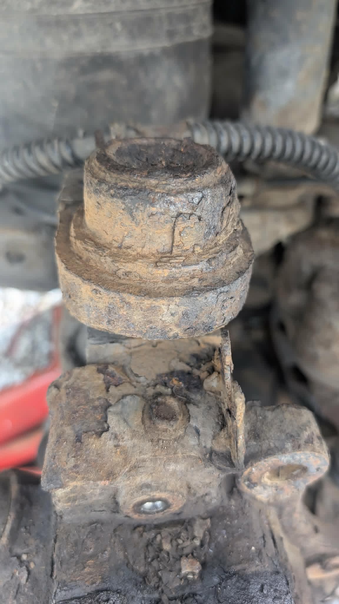

Today I've done the job, or at least 3/4 of it, that causes most P38 owners to start to panic, top and bottom ball joints.... This is on the red 4.0SE bought getting on for a couple of years ago now, now referred to as Cherry. MoT is due next month but last year the tester noted a missing boot on one of the anti-roll bar drop links and split boot on the offside bottom ball joint. He said that it should really be a fail but he knew that I would do them anyway. There was also a bit of slack in the drag link ball joint where it connects to the steering box but that didn't go on the certificate.
Did the drag link ball joint and replaced both drop links a while ago and while under there, looked at the ball joints. Now the offiside bottom ball joint did have a split boot, but the nearside one, which he hadn't commented on, didn't have a boot at all! So today I got stuck in and started on the nearside. Only had to use the Irwin extractor on the dust shield bolts, but did have to resort to the old brake disc on back to front and belt it with a sledgehammer to get the hub to move. Even the ABS sensor came out without a problem but the ball joints appeared to not have been touched since they were fitted 29 years ago, extremely well rusted and had lots of play, so they did need doing. The taper on the top one let go when undoing the nut so got the angle grinder out and cut the nut off......
However, they both came out. Top one needed a lot of pressure and the application of a MAPP gas blowtorch, before it let go with a resounding crack.
Cleaned everything up and got ready to press the new ball joints in. Bottom one went in surprisingly easily but the top one didn't want to go in straight so decided to have a break, get something to eat, watch the Spanish Grand Prix and, while doing so, put the ball joint in the freezer. Got back to it a couple of hours later, warmed the hole dropped the ball joint in, put the press on it and it slid straight in. Put everything back together and started on the other side.
To make me feel confident, things were coming apart easier than on the nearside until I got to the ABS sensor. Would it come out, no chance. Put an old 1" wood chisel in there and chopped the bottom off, that at least allowed the hub to be removed. Once the hub was out, the remains of the sensor could be knocked right through. The sensor and copper bush are completely destroyed but I've got spares of both. Admittedly, the spare sensor I've got is a rear one but the overall cable length is the same, just the grommets are in a different place but can be made to fit. Undid both ball joint nuts, top one cracked the taper again so sliced the nut off and out came the swivel. Decided to call it a day and continue tomorrow when I get back from installing an AC system. If I don't have time or don't feel like it, it'll have to wait until Tuesday.

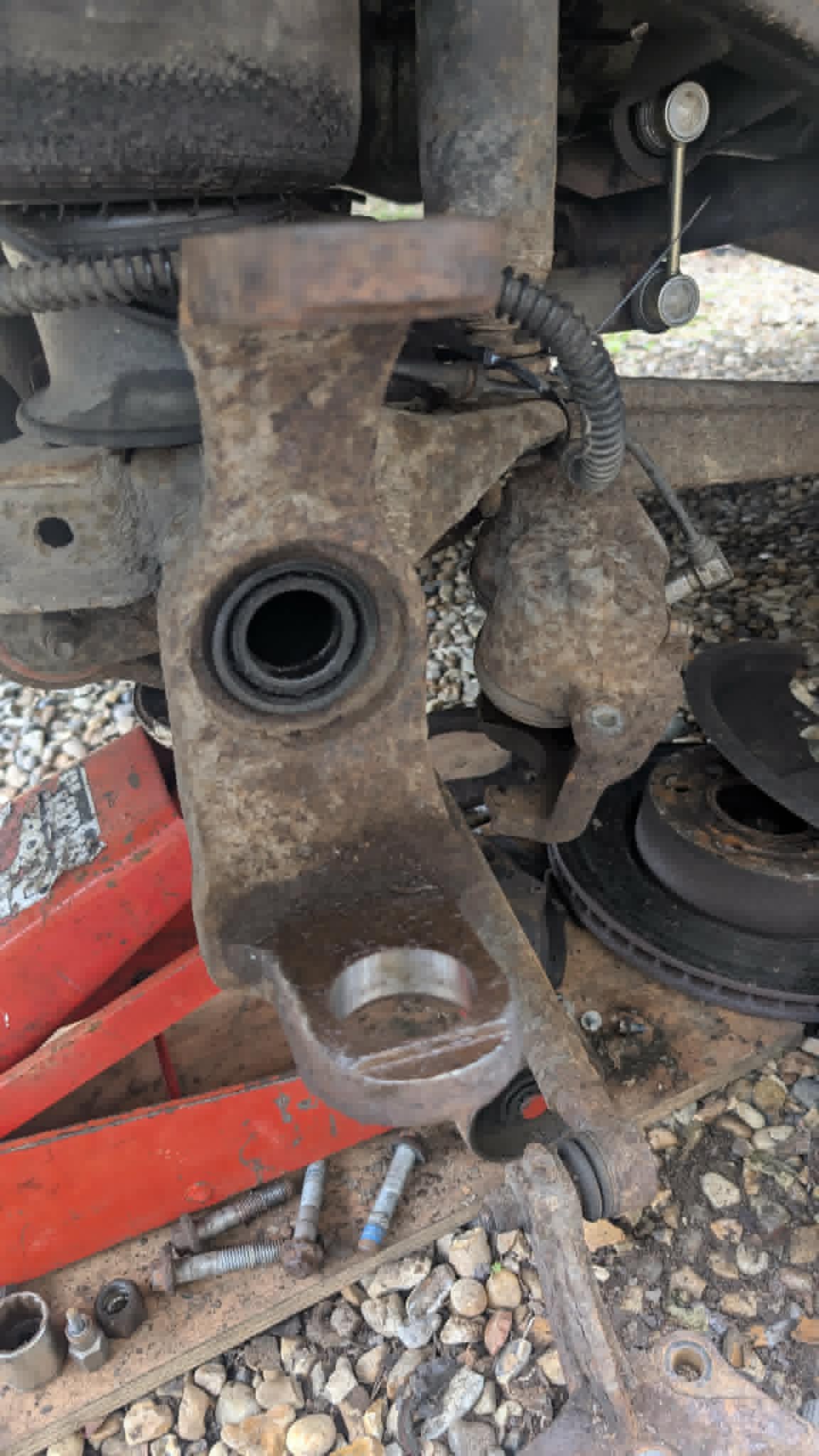

With the MoT on mine coming up next week, I'd previously had a good look around to see if I could find any possible advisories and noticed the radius arm bushes looked a bit worse for wear. As I'm still stupidly busy with AC installs, had a look to see if I could find a pair being sold that I could swap in and replace the bushes in mine when I had more time. Zooming in on pictures of ones being sold on eBay, the bushes looked to be in no better state than mine (quite why anyone would even want to buy used radius arms with knackered bushes, I've no idea). So decided to buy the bushes and the special tool for fitting them.
Taking the arms off, one at a time, wasn't difficult, the old bushes came out easily using assorted bits from the kit used for replacing top and bottom ball joints and one of the 3 bits that came with the tool. The only problem with that is as the bushes were worn, the centre tube wasn't in the centre. That meant the bit that is suppose to push on the outer was hitting the edge of the hole it fits in, but with a bit of extra grunt it slip down the slight taper on the inside of the hole and centralised itself. Then came to using main part of the Britpart copy of the LRT-60-004 tool. The bushes are fatter than the hole they are fitted in, so the tool has a tapered bit that the bushes are pushed into so they are squeezed down to the correct size to go into the arm. First problem I noticed was that as the mandrel that pushes them in has to be narrow enough to fit into the narrowest part, it was pushing on the inner edge of the bush outer and trying to splay it outwards making it difficult to squeeze it in. Second problem was that I couldn't use the clamp from the ball joint kit as it wasn't wide enough so had to resort to using the 6 ton hydraulic press in my neighbours garage. To stop the bush being splayed out, found a suitable size mandrel in the ball joint kit, that would push the bush into the tool and then use the, slightly narrower, one that came with the tool. After coating everything with oil so it would slide easily, the claimed 6 ton Chinese press, got the bushes in fairly easily.
Refitted that radius arm so the axle was at least held on at one side and then took the other one off and repeated the above. Even after having to wait for my neighbour to get back from being dragged around Tesco by his wife, got it all done in a day (including stops for lunch and to watch the Sprint race and qualifying for the Dutch Grand Prix). So not as bad a job as I had anticipated but would have been impossible without the tool. Now just got to wait and see if I can get another MoT without advisories despite the current 562,000 miles.......
