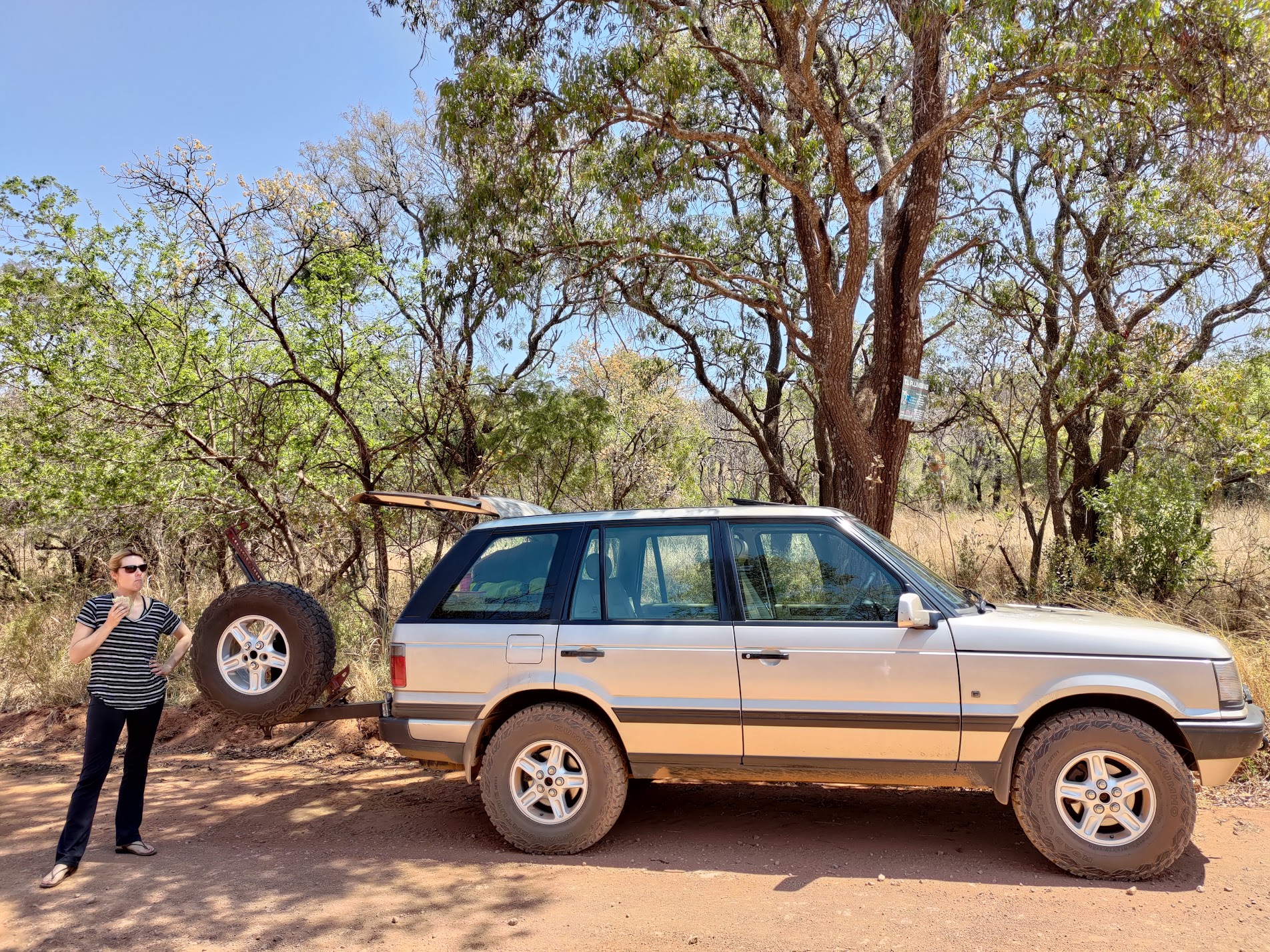

Anyway, there is absolutely no rush for me to get any of this done, the RR is running beautifully and getting used quite a bit.
