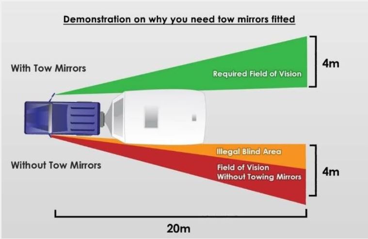

I was under the impression that the mirrors needed to be far enough out that you would be able to see directly behind the trailer. However, a bit of research has come up with this
So I can see that if you are towing a caravan or box trailer that is wider than the cars existing mirrors, you need the extension mirrors. Despite the fact that the field of view of the Ring mirrors I bought is so narrow that I doubt they meet the rules. In my case, the boat has a maximum width of 2032mm (80 inches) so 143mm wider than the width of the car. But, as it is a boat, it tapers downwards so is narrower on the part of it that is at the height of the mirrors but at ground level I can see what the diagram says I should be able to.
your spot on Richard with that if the trailer is wider than the vehicle you need extention mirrors on so you can see down the side of the trailer/caravan as far as the back corners on both sides and a little behind
my cheap extentions does just that so not to bad but like you said the mirrors on the P38 are loads better than the extentions

Since it's only the 'illegal blind area' (marked in orange) the extension mirrors can really be almost total crap, and still be legal and do what they're supposed to do.
But of course, properly stable, convex mirrors are of much more help.
