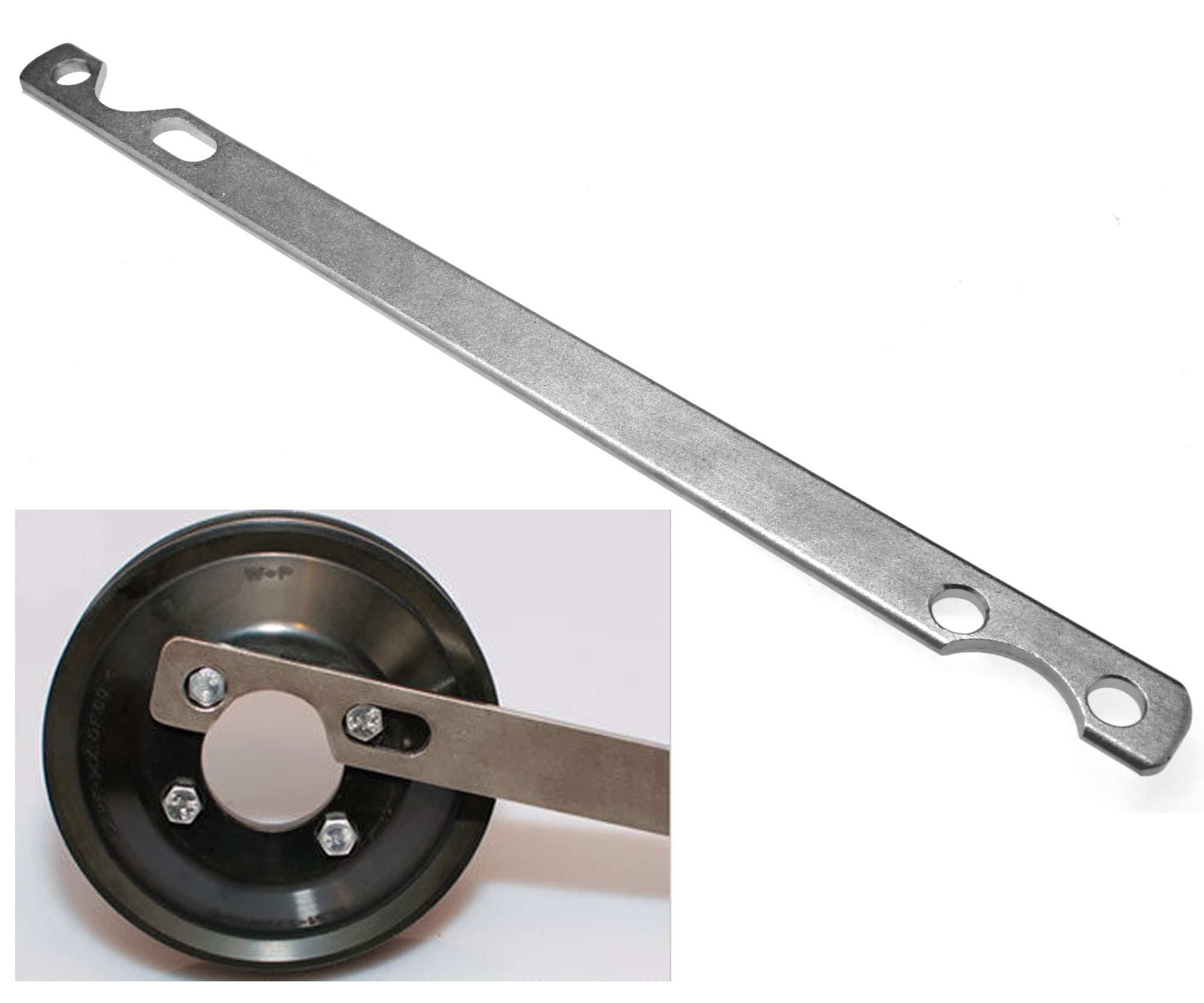

Forgot to ask, did you require any special tools to remove the viscous coupling and fan? RAVE mentions special tools but are they strictly necessary?
Posts: 501
Ha, I just replied to your other post LOL
I made a tool to hold the pulley still while using a 32mm spanner on the fan hex.
I just used some flat steel bar approx 12mm x 2-3mm with a hole drilled near the end big enough to fit one of the pulley bolts.
Put that on the pulley and heave with a spanner.

Ta, I shall make sure I am suitably equiped.
