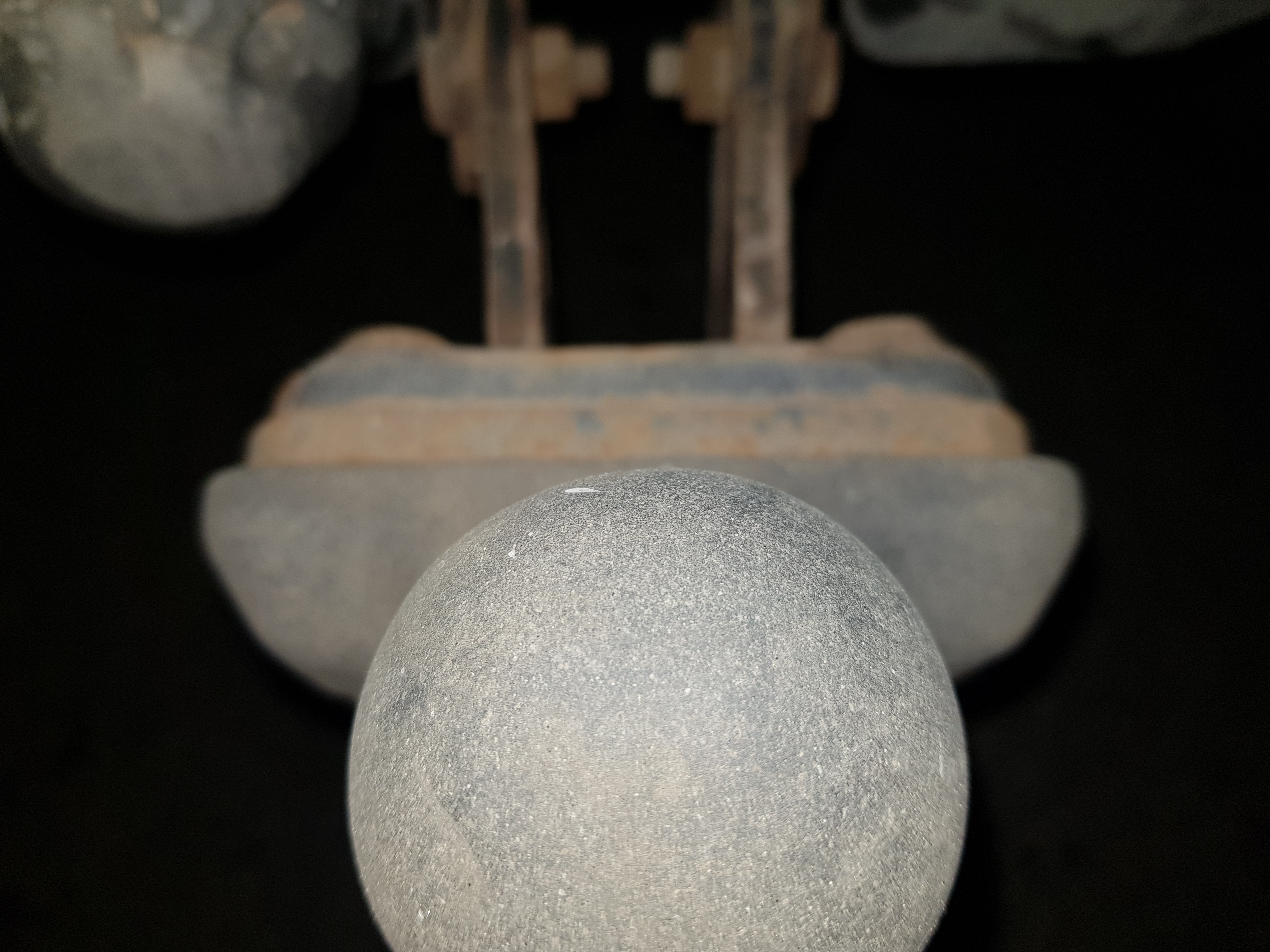

In addition to the front recovery point, there's the tie down point which is a loop of steel of one of the chassis rails and is a lot less substantial so wouldn't be any good as a recovery point. As it's also above the bottom of the front bumper if you did try to use it you'd need to take the bumper off first anyway. If you've got the after,market towbar with the bolted on ball, I don't see why you can't attach to the towbar itself. Not sure how I'd do it with the factory swan neck towbar though (if I ever had need to).
Not only is green laning and offroading different in the UK to the US, we have different towbars too that don't use the square section socket that you have. In fact, the US standard ones are illegal in the UK, if fitted on an import it must be either removed or disabled (welding a plate over the hole is the accepted method.

For illustration, here's a very bad photo taken on a phone at night...
Probably should have taken the rubber cover off
