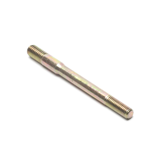

Just swapping over the brackets from the old cylinder head to new and also the bolt from the front of the R/H ( passenger side) cylinder head that goes to a part on the aux belt.
I cant undo it as it doesnt have a fixed nut, Ive tried using grips to no avail. Does any one know a part number or name of this bolt.

Posts: 8637
Looks to me like it's ERR6445 (a stud with a 3/8 UNC thread at one end and an M8 at the other) but earlier ones used a 3/8 UNC bolt which is ERR6444.
Posts: 290
I think you are right Richard, oddly none of the usual dealers have a picture though they sell it.
I only found 1 picture on google and it looks the same as what I need.
