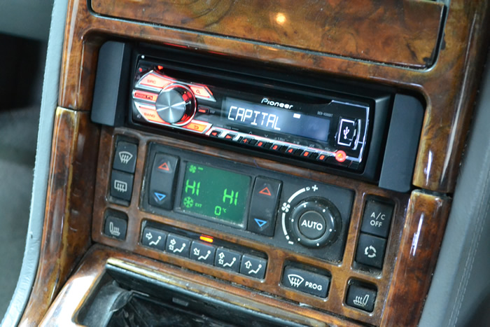

If you don't mind changing the head unit, then something like this https://www.kenwood-electronics.co.uk/car/rec/dab/KDC-BT950DAB/.
Dear Gilbertd,
I see this is a DIN1 unit. Is this a simple slot in? I'm OK with the wiring etc but mechanical fixing, does it just slip and clip in or do you need adapters?
Posts: 672
Paul, it goes straight in, provided you mount first its 'cradle' (should come in the box together with the radio).
Since the shape of the OE radio is not squareish, there are available some "inserts" to fit on the side.
See here
https://www.cartronics.co.uk/media/rangerover%20radio%20replace/New%20radio%20in%20Range%20Rover%20using%20original%20amplifer.jpg
Posts: 672
Ah, in my case (Pioneer X3500) also the ISO connectors were a direct fit to the radio, only the CD changer (which was discarded as no longer working proper) and the steering wheel (for which an adapter is available) connectors are not an usable option...
Posts: 96
See here
Thank you, one ordered and on its way, what did you do about the FM and DAB aerials?
