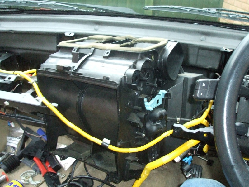

In my P38, I have a strange thing happening. If I have the HEVAC set to say 22c, and the air set to come out of the face and footwell vents, once the temperature in the car reaches the set temp, the air from the dash cools off a bit as it should, but the air coming from the footwell vents is constantly hot. If I set the air to only come out of the footwell vents, its also always hot. This becomes a bit uncomfortable after a while, unless I set the air to only come out via face or screen vents. The air does go cold from the footwells if I set the temperature quite low though.
What does your car do? I don't know if I've cocked up rebuilding the heater box, I'm pretty sure I haven't. Blend motors are calibrated, though really shouldn't make a difference as the temperature coming from each vent (per side anyway) should be the same regardless of what the HEVAC thinks, and the distribution works fine.
Looking at the old one, the air to the footwells goes back down over the back of the heater core section, which I guess could be warming it up, but I wouldn't have thought enough to keep it properly hot.

I have no idea how I've managed it if this isn't normal. Even if I'd not lined up the distribution flaps properly, that would just mean I'd have air coming out of places on the wrong settings... but they all behave as they should. The only thing I can think is that where the footwell air passes back over the rear of the matrix section, when air is passing through said section, its heating up the rear plastic, and then the footwell air is being heated by that. But it seems very hot for that amount of heat exchange to be going on...
This is the bit I mean, with the front panel that keeps the air going down to the vents in place.

Right it isn't heat coming off the back of the heater core - drilled a small hole at the top of the rear panel just before the air starts passing over the heater core, stuck a thermocouple in, and its hot up there as soon as the air starts coming over.
What the hell have I done... to confuse things further, the passenger side dash vents are also colder than the drivers side. But both footwells seem to be the same.
What I have found is that with the blend motors on anything less than 100% (ie, hi/hi), the dash vents are cold once the interior has warmed up. As in, they are at least 10 degrees cooler than the footwells. That's shit. Looks like the dash is coming back out again. I'm getting mighty fed up.
