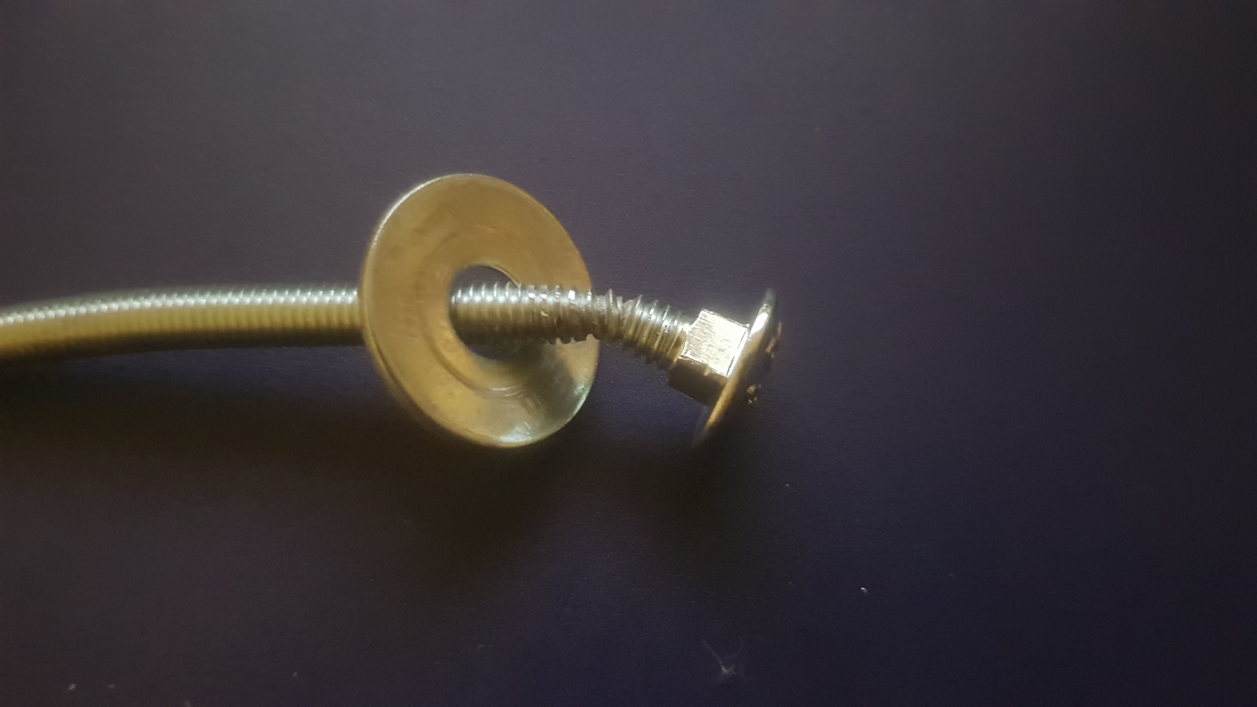

I know M12 sounds a little excessive but here's what happened to the M6 bolts when I tried them:
Posts: 8636
Not a straight pull then......
However, that does look like a roofing bolt, usually made from a grade of steel marginally harder than plasticine.
Posts: 2524
Yeah, I've no idea what steel it is. It just came out of the "Coach bolt" selection at the local hardwarw place.
Keeping the puller straight is the real issue. Once I start getting decent tension on it, the puller just flops over.
There's not enough space for washers behind the wheel so I think my next plan is either to find a puller with bigger slots or to drill the holes to the size of the biggest bolts that fit the puller (m8, like the thread that pulled out) use nuts behind the wheel again and hope the tighter holes keep the puller straight so I can get even more tension on it.
edit: It's a 4.8 steel bolt, so about half the strength of 8.8 Ah well, I doubt even a really strong bolt would have helped when pulling sideways :(
