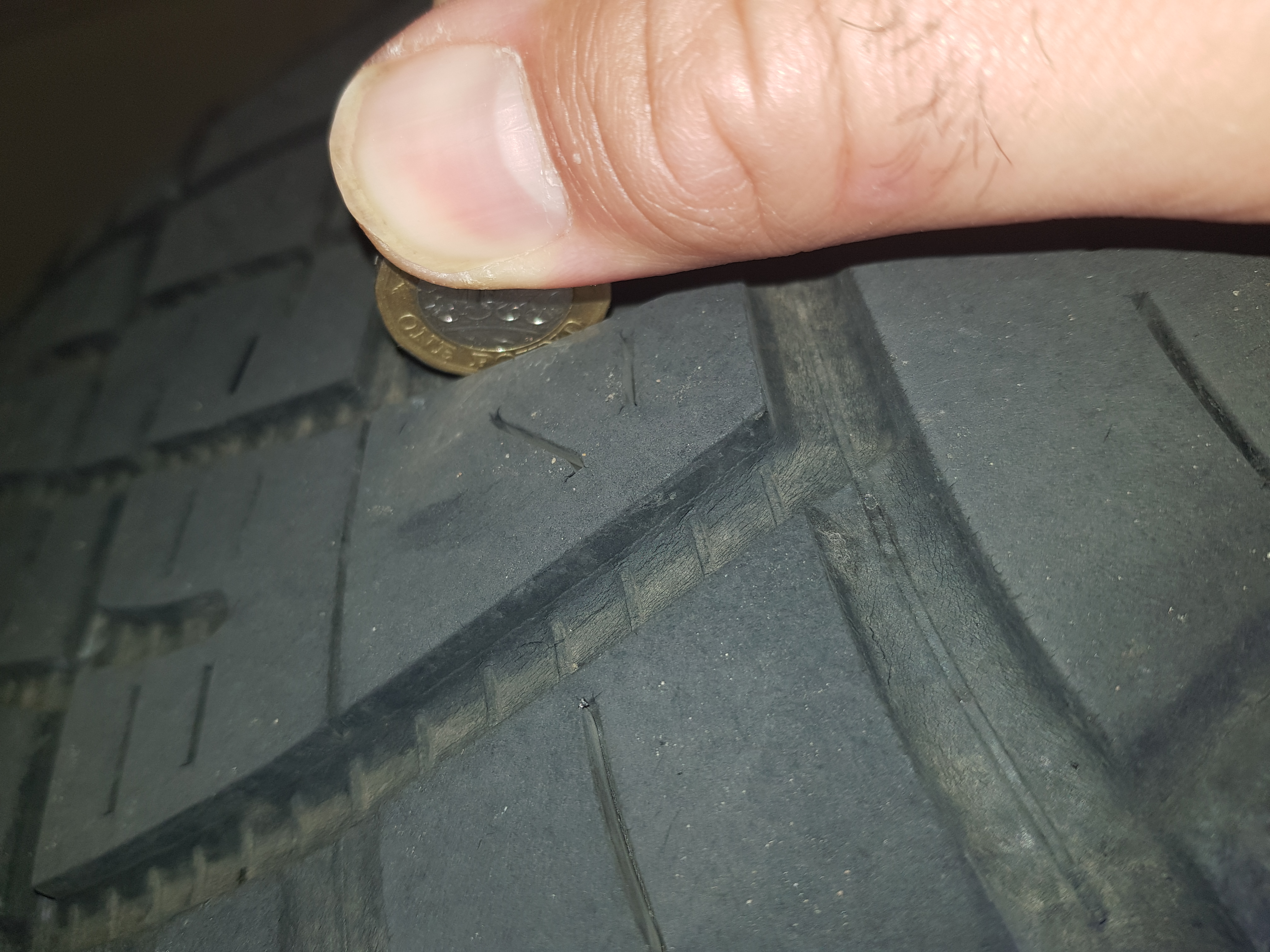

Posts: 2510
They're badly worn at the left shoulder on each front tyre :(
Posts: 8395
As long as you have a tread depth of over 1.6mm over 75% of the width, then putting them on the back will be fine.

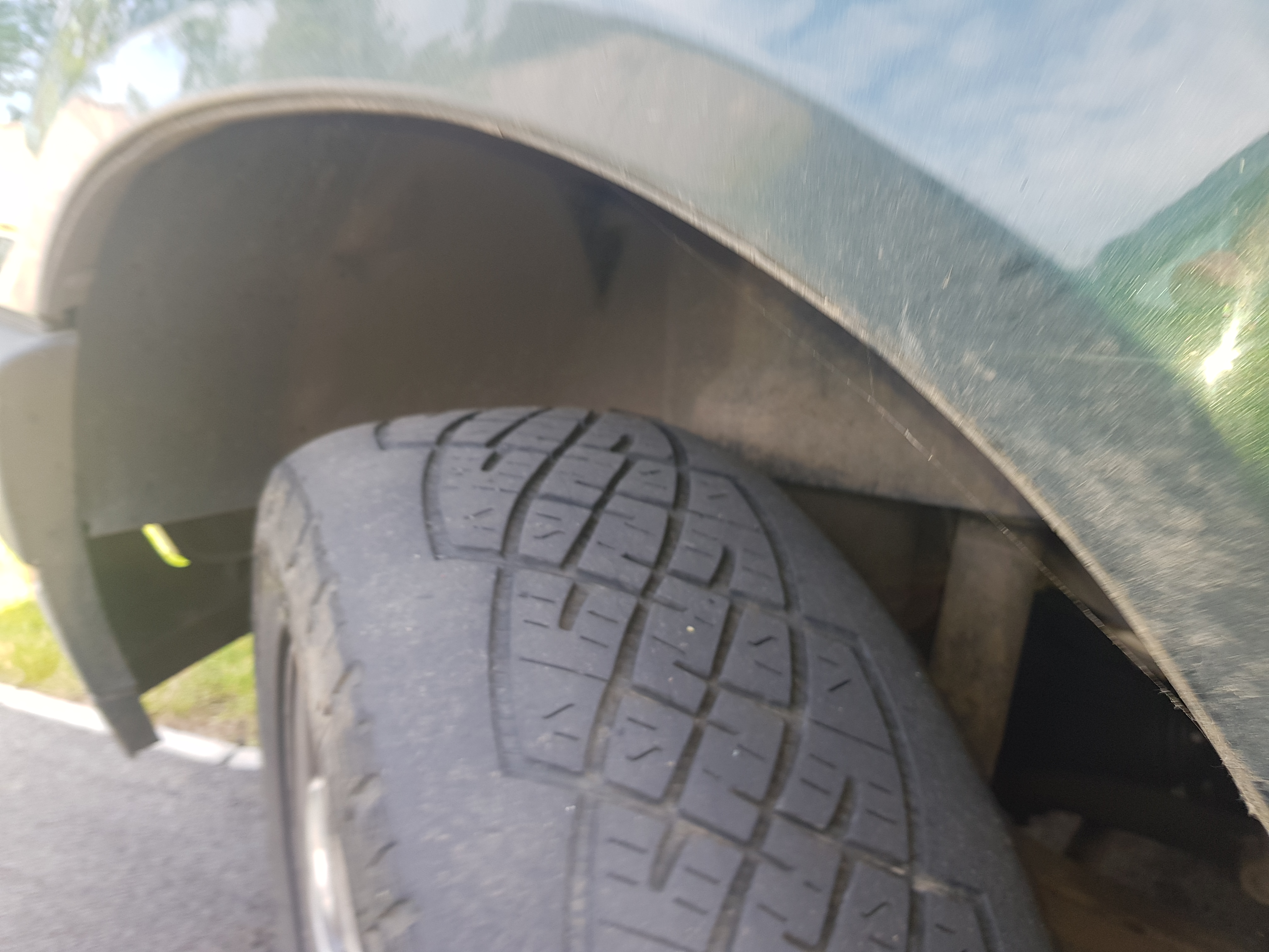

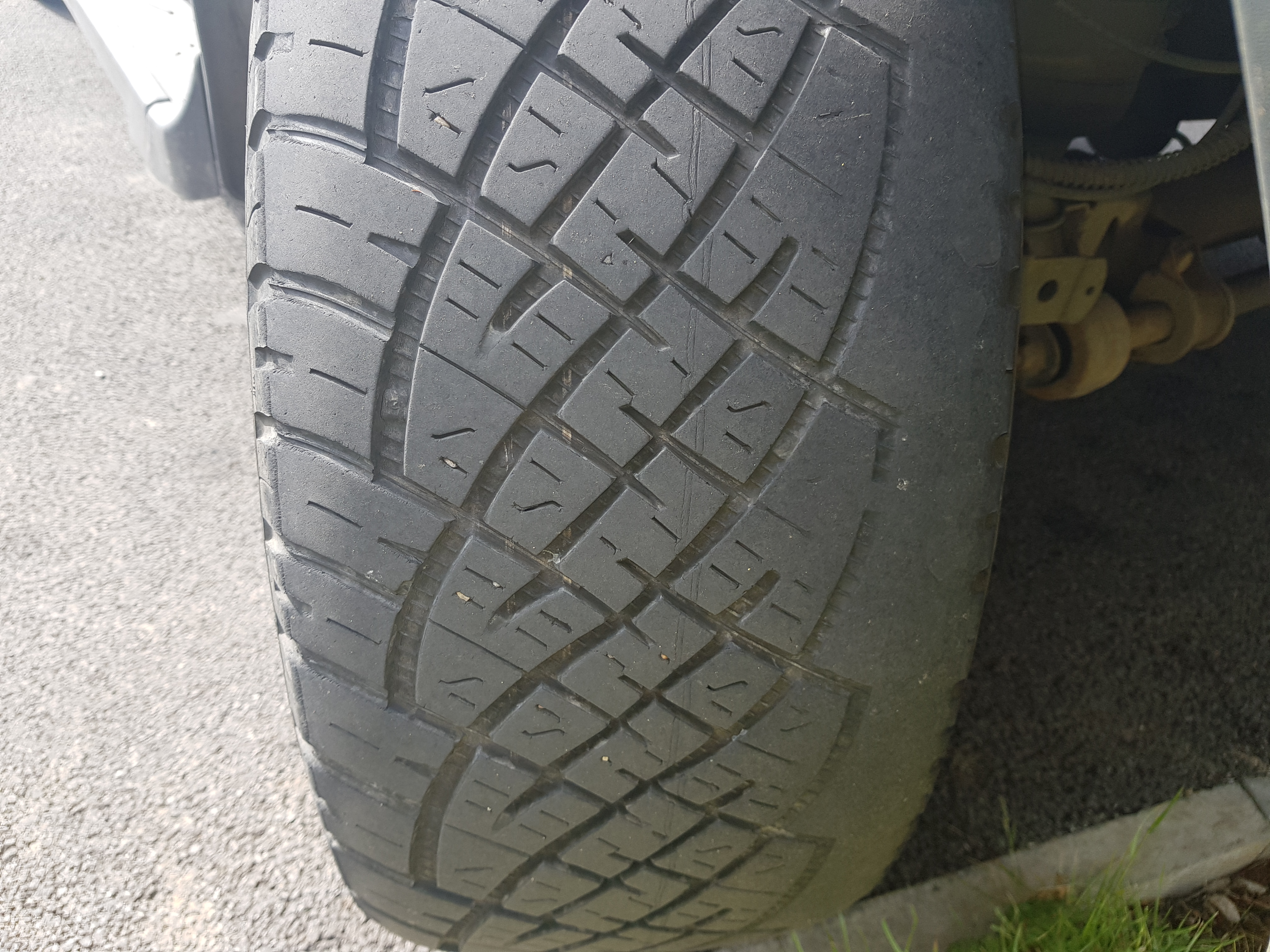

Posts: 2510
Well they're not looking great at the front :(
Compared to the Rears which are nice and uniform.

Posts: 8395
There's plenty of tread over 75% of the width so perfectly legal, I bet there's hardly any difference between them and the rears in the centre. Bung them on the back and the ones from the back on the front. Just don't forget to change the pressures.
Posts: 814
Morat - have the front tyres always been on the same corners? The wear pattern is a bit odd - it's almost as if the whole axle is tilting to the left - or you're driving around an oval racing circuit in the same direction. I wd swap the tires as Richard says (front to left, but also left to right), but I'd be trying to figure out what was causing the issue before you do the same to the rear tyres.

Posts: 1141
The front left wear does look like what you'd expect from under-inflation, wear on both shoulders with the middle much less worn.
Posts: 572
the first tyre is an under inflated issue, the second is a toe out issue, if it was worn in the middle it would be an over inflated issue.

Front Left, apart from being underinflated, was also much more worn on the outside shoulder, whereas the Front right was worn on the inside shoulder - and the difference between the shoulder and the centre of the tread is over 4mm depth so it's quite a severe gradient. That's on the correctly inflated tyre :(
Posts: 8395
The front left probably caused the front right to wear. A soggy tyre on the left will cause the steering to pull to the left, so you will be constantly turning right to keep it straight which will wear the inside edge on the RH tyre. If you'd kept it pumped up, both would still be good.......
