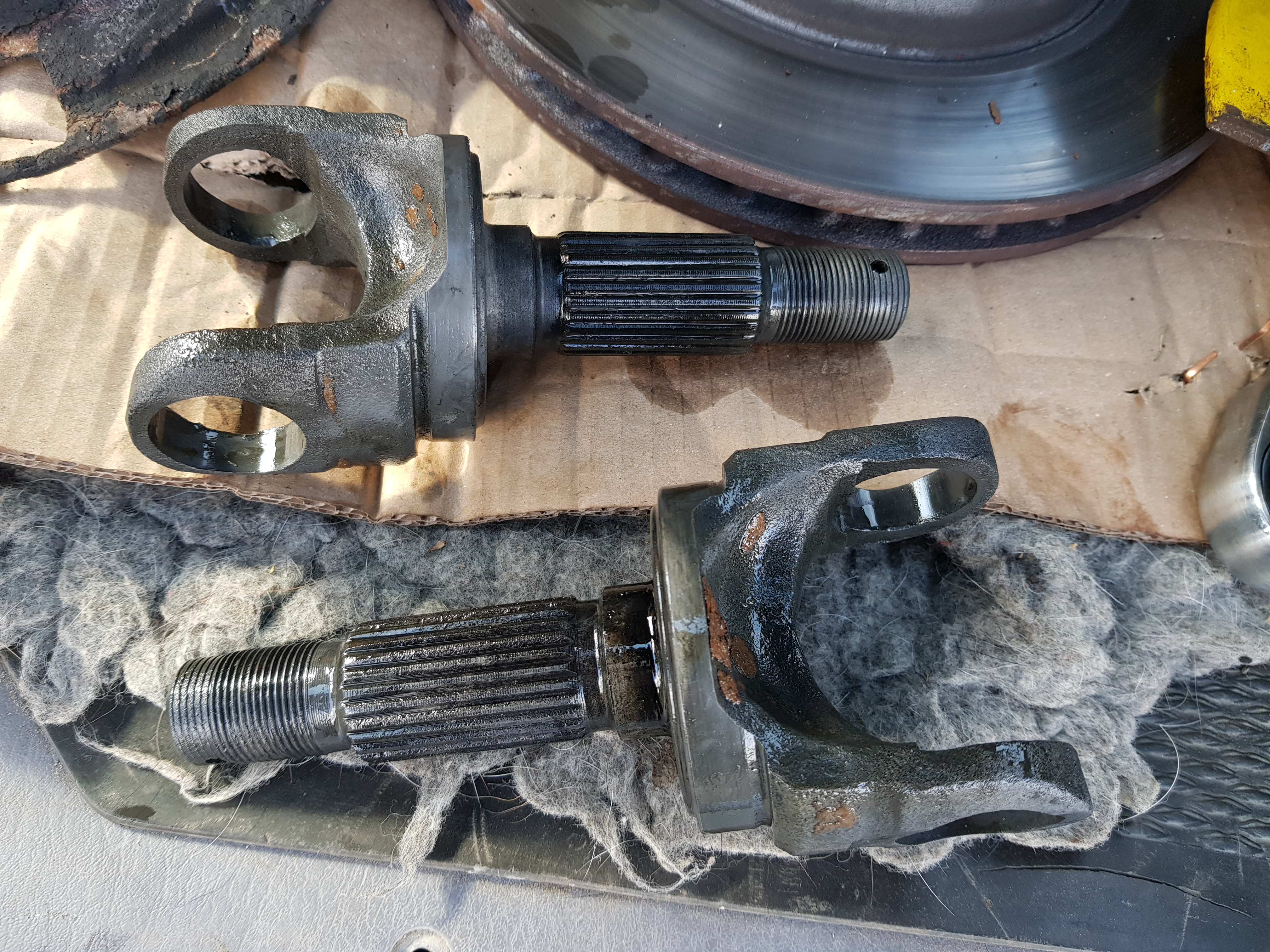

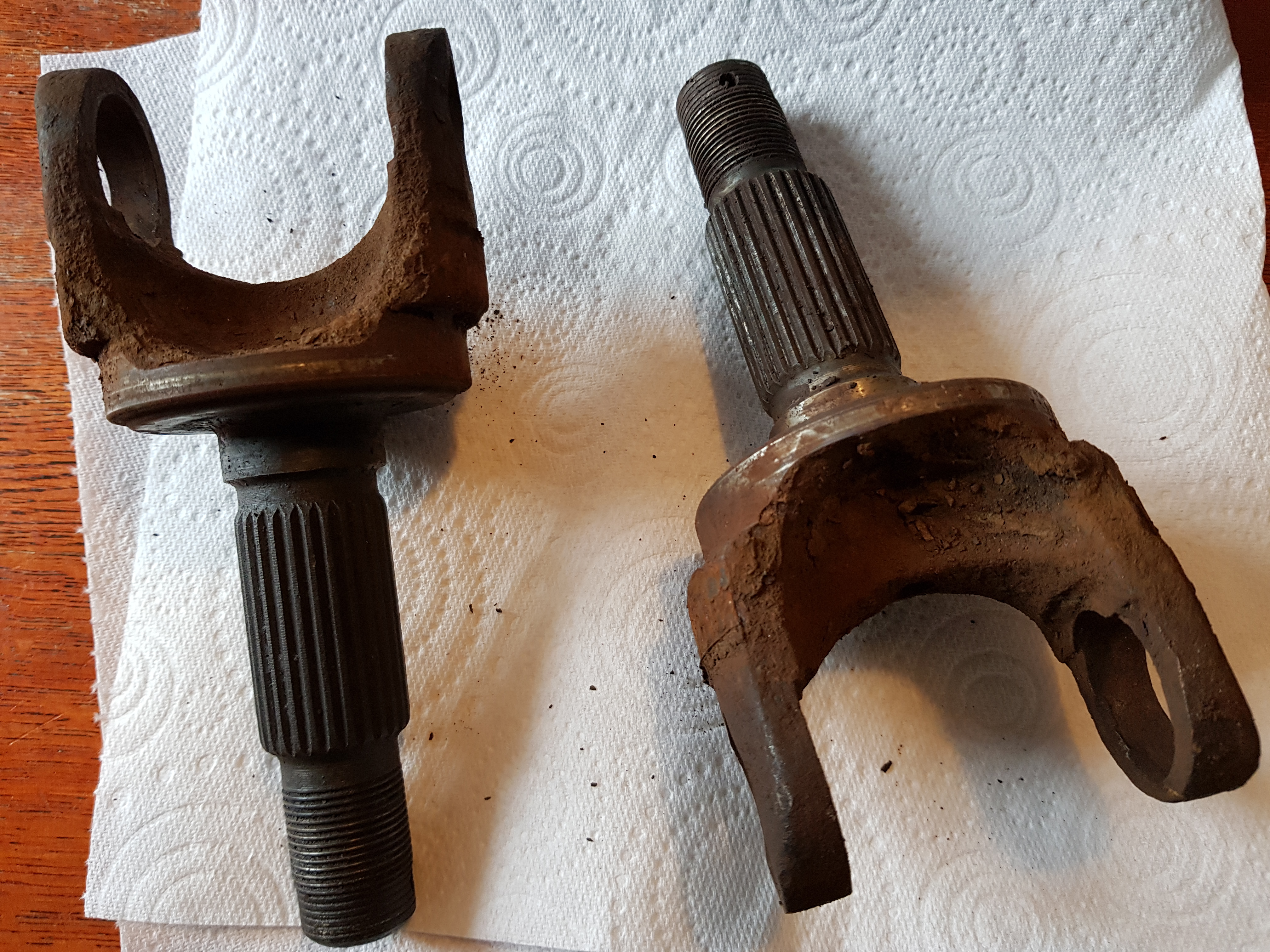

heh, it took me so long to find the pictures you've already replied.
It's non toxic so you can use it without any stress. I did wear gloves because it doesn't smell great but I did get some on my hands without any issue. Soap and water.. not exactly unusual these days!
Before:
enter image description here
Not perfect but good enough for something I don't plan on seeing for another couple of years! I mixed 6l of water with 300g of DeoxC which is the minimum recommended strength. I left it in for two days (which made the less corroded bits go from shiny to dull again) and only bothered to scrub them a couple of times. You're meant to get in there with a brillo pad or similar every hour or so and not leave them overnight but my lazy arse gene kicked in.
After:
Then you just rinse them off with plain water. If it's something like a body panel and you're worried about flash corrosion you could use something like de-greaser and go straight to a zinc primer or Hydrate80. Not relevent in our cases of course.
