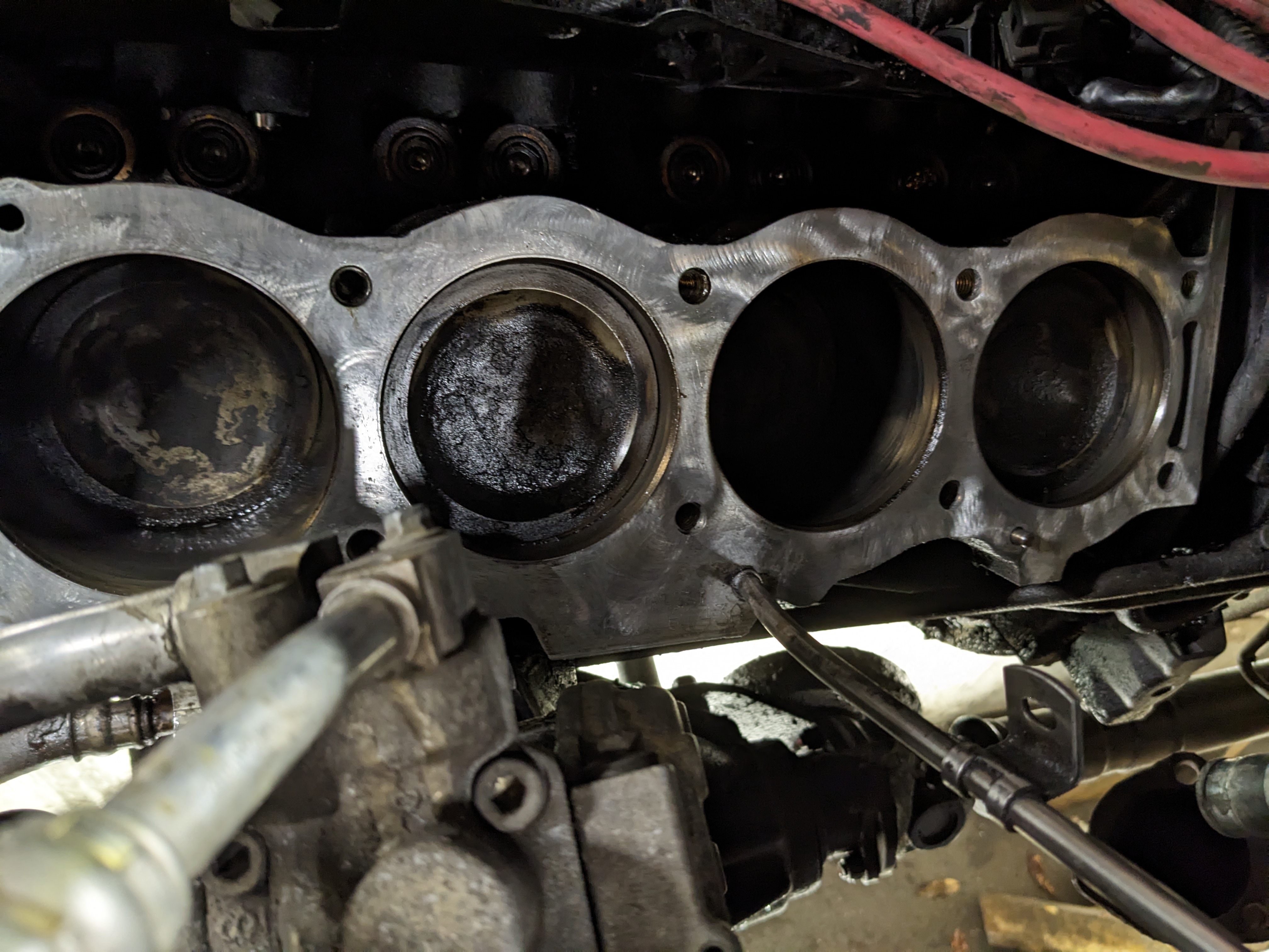

The HG had a nice big hole in the side - luckily the block doesn't appear to have suffered so I'm just getting one side done. I hope this cheaping out doesn't bite me on the arse in a month's time but I gues we'll just have to see.

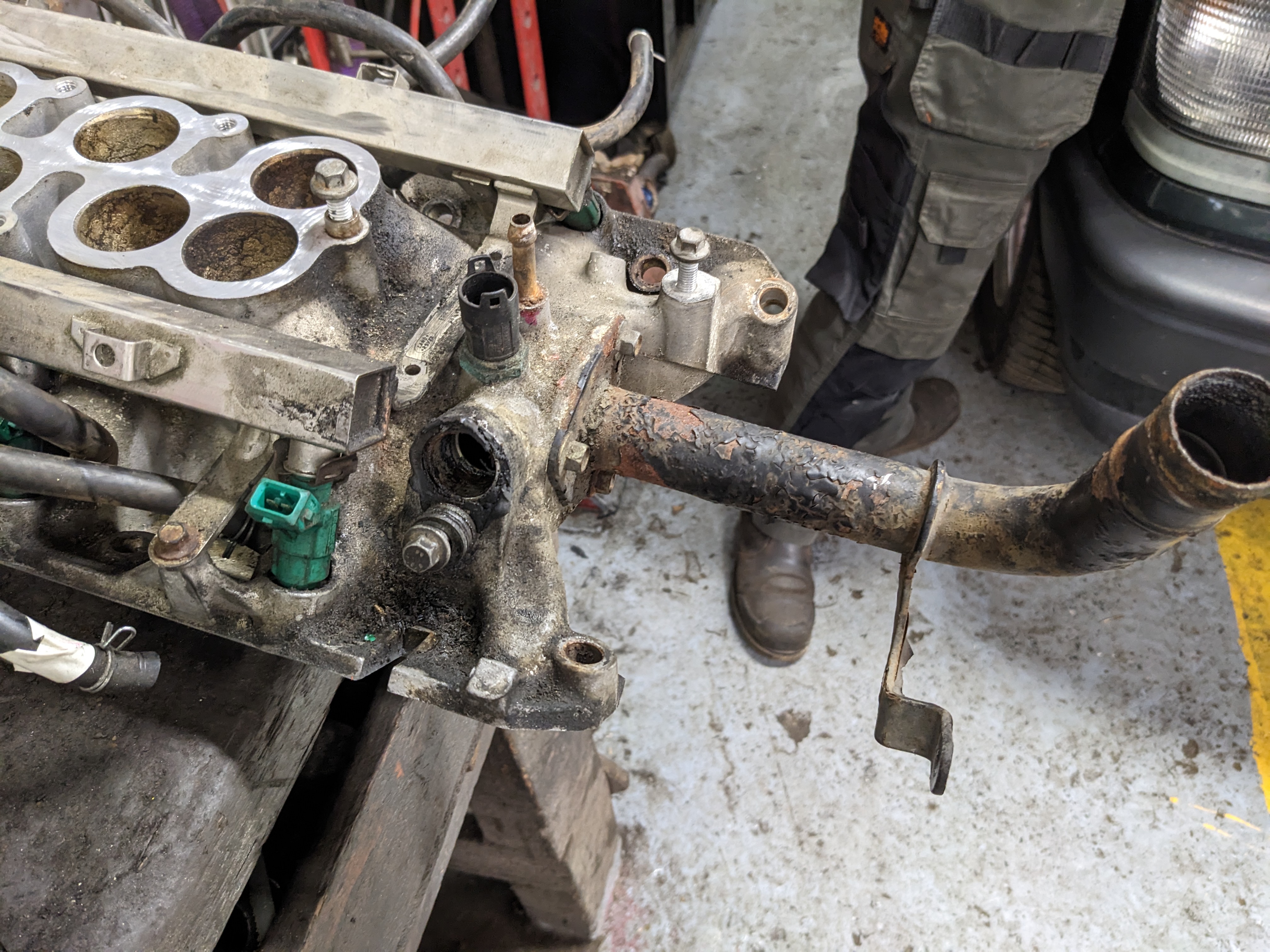

There's only one "While we're at it" that we're aware of. This metal pipe to the intake is horrible and rusty. It seems to be one of these: https://rimmerbros.com/Item--i-PEQ000030P1 which is available (yay) or I can pay an extra £20 for the Green Oval. I'm tempted to just get the cheap one powdercoated. What do you reckon?
Crusty old pipe!
In other news, the liners pass the fingernail test - so I'm hoping that the worrying ticking noise was just the HG in "pre-failure mode". Unless it was the other bank, of course! :)
Here's hoping
Posts: 8640
I'd go for the cheaper pipe and slobber it in Hammerite paint (or just give the one you have a good wire brushing and slobber it in Hammerite). Where was the gasket blowing? Out the side or into the Vee? Into the Vee can usually be confirmed by the noise increasing if the oil filler cap is removed, out the side can often bee seen as flames coming out of the joint. However, this can only be seen from underneath and the joint will be concealed from view by the exhaust manifold, hence the original (wrong) diagnosis.

It came out of the side, hidden by the manifold as you say.
