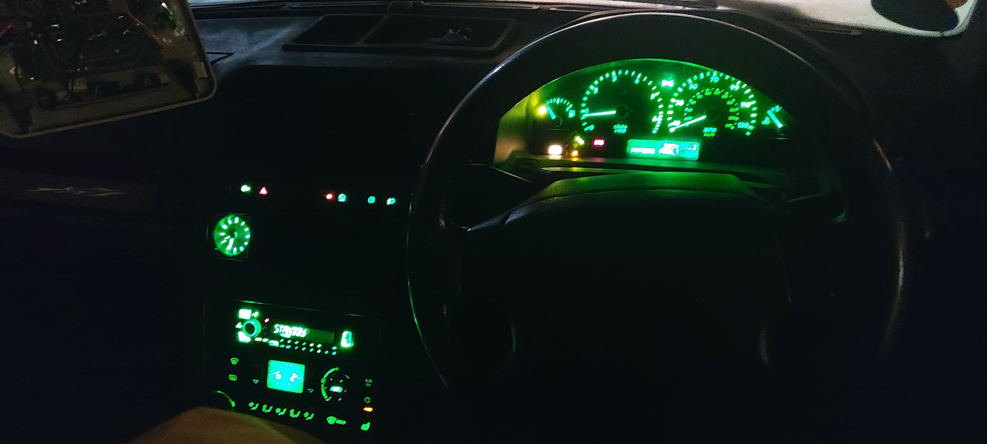

Here's what a fully LED dashboard looks like, they do dim as well.
