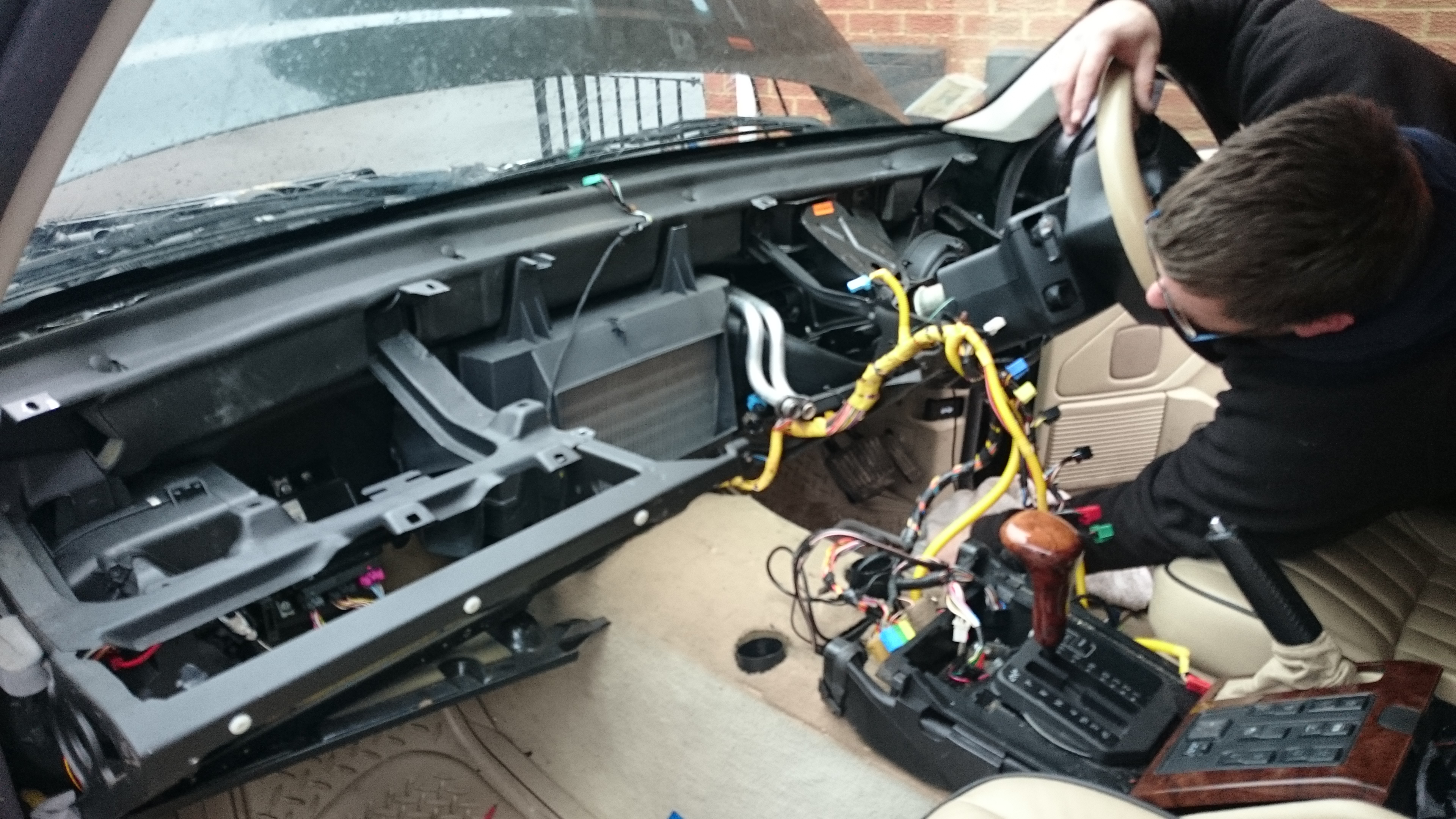

This is as far as mine came apart...
Might well be my problem then Morat!
I'm trying to get the whole thing out, when, as can clearly be seen in your pic, I need to split off the back section. From your close observation of the work, is it just the one screw (centre top on evaporator housing) that holds the two parts together?

Your pic of the evap housing really helps though. Now I can see where it splits I can work from there and the heater won't end up looking like the headlight I removed...
