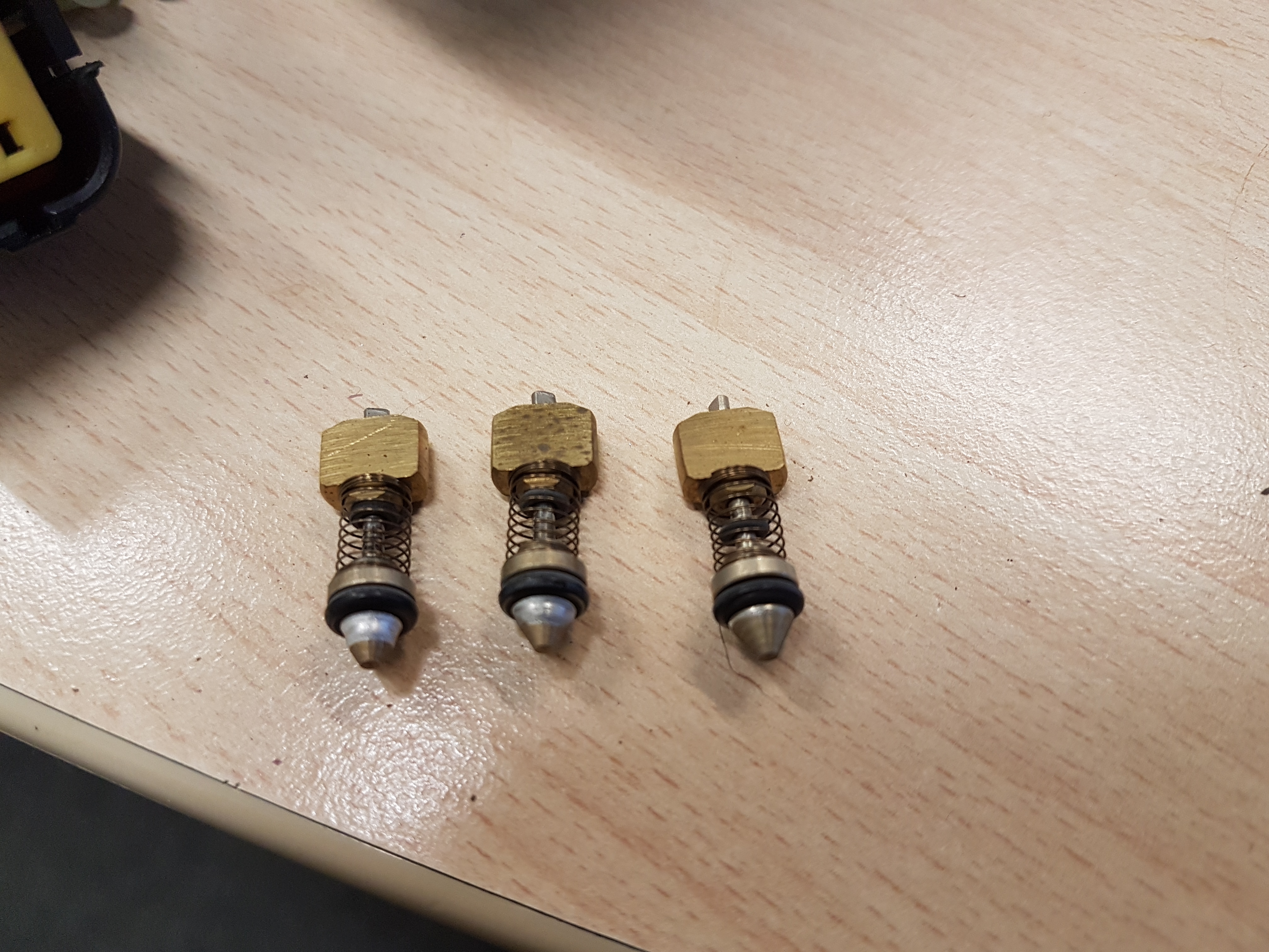

The titanic has landed. Or been raised, or whatever. One actually looks pretty good. I guess the other two are serviceable with new O rings.
Very Small Parts whot stop your car from rising
I can't help thinking that I really should have bought a 3D printer when I had the chance...
RH one looks good, others will probably do.

Can you buy non return valves seperate or do you have to get the full block?
Posts: 668
Is this a hint that its about time Clive got round to tooling up and making a batch of new pointy bits to recondition the valve insert doobies?
Theoretically I have some uncommitted time next year.
Clive
Posts: 784
if you can't buy them, it would seem like a sensible line of work to be in.
Do it quick before Morat buys a 3D printer!
Posts: 8263
I suspect a 3D printed part in plastic wouldn't last that long but if someone, like Clive, has a small lathe, it should be relatively easy to make the pointy bit (assuming that comes off the rest of it) in brass or alloy.
Can’t say I’ve ever really looked as to wether or not they can be split, if they can then I’d be interested if Clive machines some, as I’m sure others would be, looks like I might be taking my spare block apart,,
Well, we know they come apart, 'cos one of Morat's had!
Posts: 8263
Yes but are they intended to come apart? I assume they must, even if the end bit is pressed on, or they'd never be able to get the spring in there.
