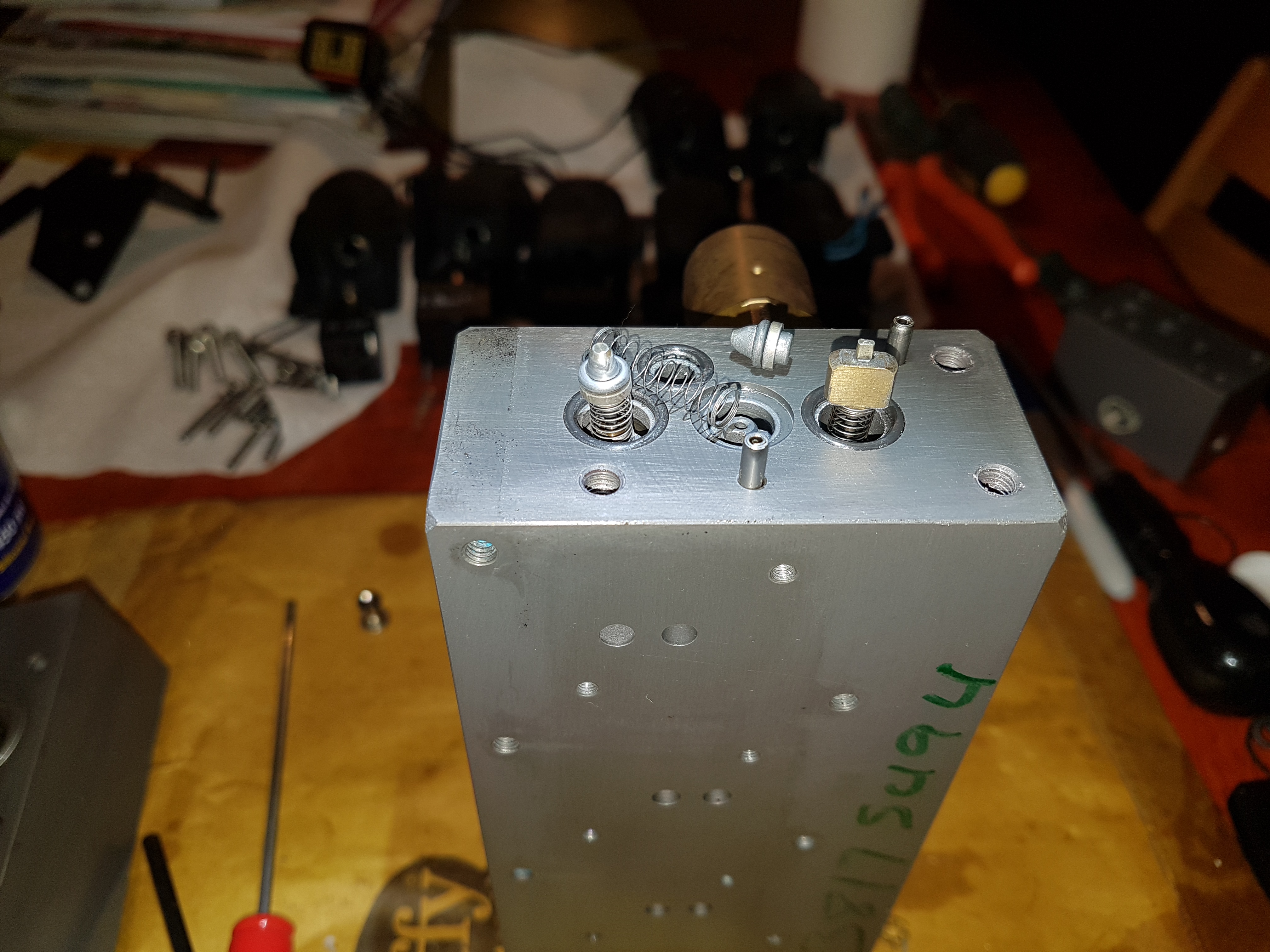

So far it has all looked in perfect nick with no sign of swarf from the dead compressor. The only horrible bit so far was this:
Posts: 2510
Houston, we have a problem :(
Posts: 2510
So, I guess that wasn't working very well :(
That'll T cut out. Just a flesh wound...

btw, is the "backwards" NRV meant to come out? The one with the cone facing inside the block. Mine seems to be stuck. I could grab it with pliers but I don't want to rip it out unless it's mean to shift.
Posts: 784
they all come out
Posts: 2510
And after a couple of hours soaking in WD40 and a really good tug, it came out. I can't imagine that was helping the air flow either.
So, one NRV welded shut, one NRV basically free floating without a spindle. One collet was missing an O ring, the Diapragm and spring were rusty as hell.
All the O rings were lovely and new! I suspect the previous owner was a bit special. He certainly had a love of blue locktite.
Posts: 784
make sure the springs are all free from gunk when you get your spare NRV's. Cotton bud and some carb cleaner will sort it. Or you can be sure that they'll stick shut. Also, don't lube the o-rings that you put on the end of the NRV's.
Posts: 2510
Yes, I think they had all been lubed. There was a lot of grey slimey grease in the holes and the NRV that was stuck was able to hold a puddle of WD40 back for about 20 seconds.
