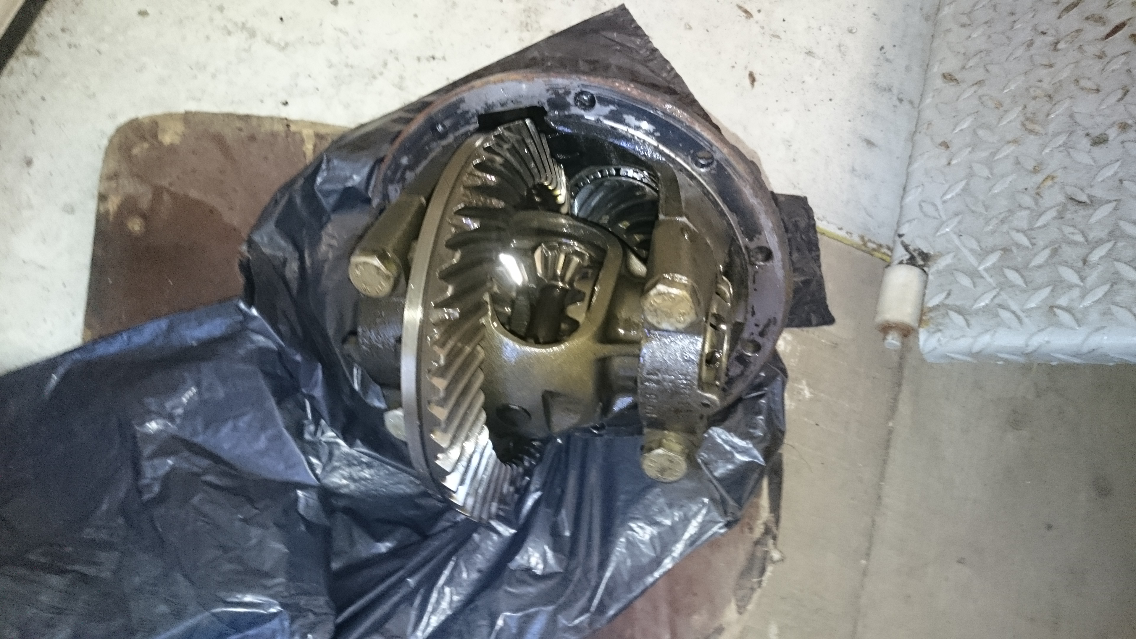

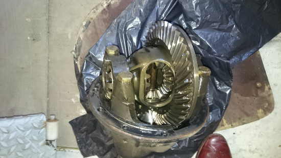

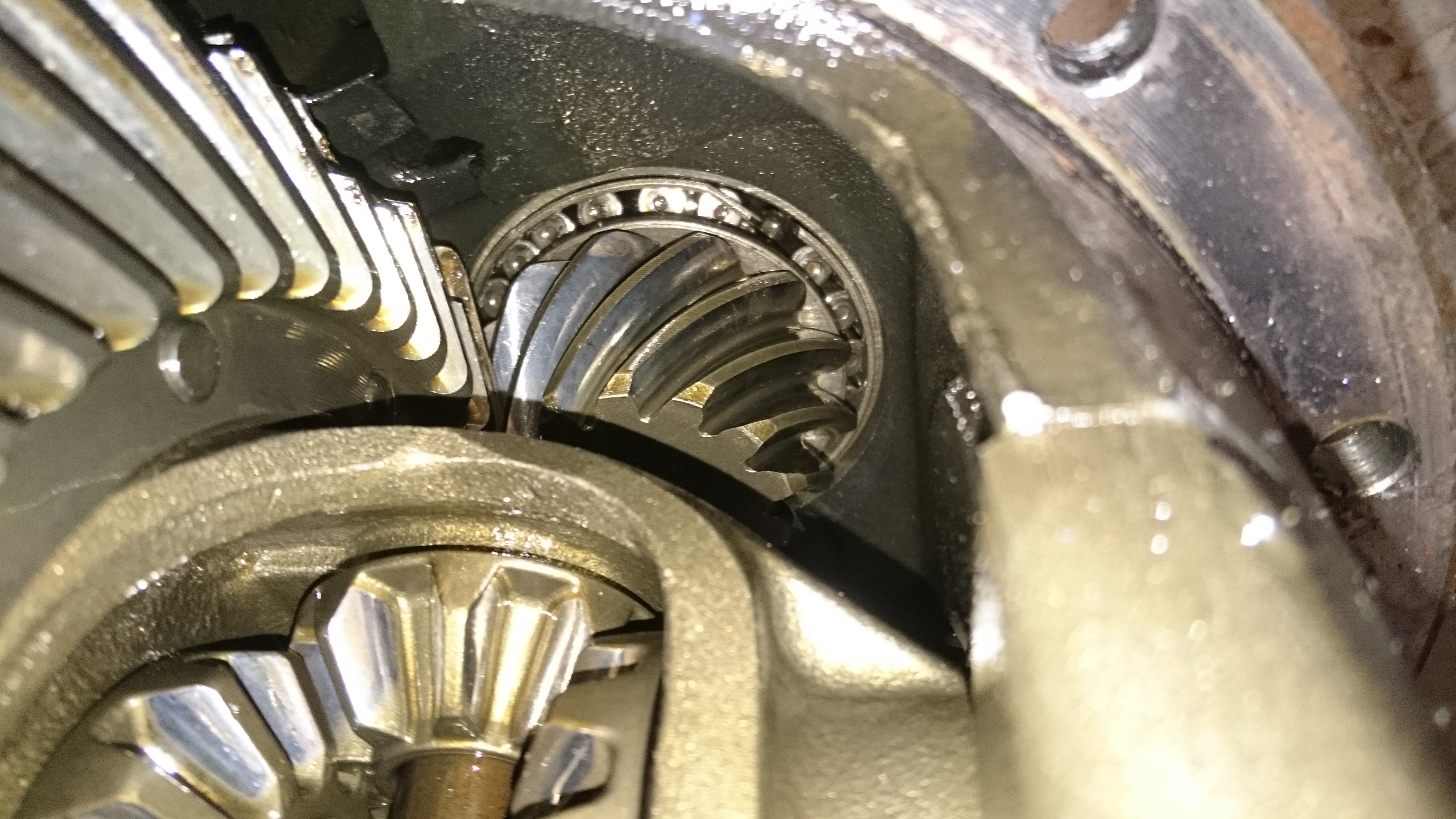

I'm sure you want to see the grim details!
It was a two pin, which is a relief. Before he even started, Bob said "Someone's been in here" based on the gasket and his final diagnosis was that someone had put new pinion bearings in but hadn't got the preload right and left them too tight by a long way. Eventually it let go and took out the rest of the diff. As you can see from the chipped teeth, it's not a surprise it was chuntering away as we drove up the M1!!!
There's a stock diff arriving in the morning. I can't afford the extra shiny so it'll have to do - and if it's installed correctly I'm sure it'll be fine :)
uhoh
Fullsize: CLICKY
uhoh
Fullsize: CLICKY
uhoh
Fullsize: CLICKY
Ouch!
At least there's no doubt about what failed!
Should be back on the road tomorrow night then...
