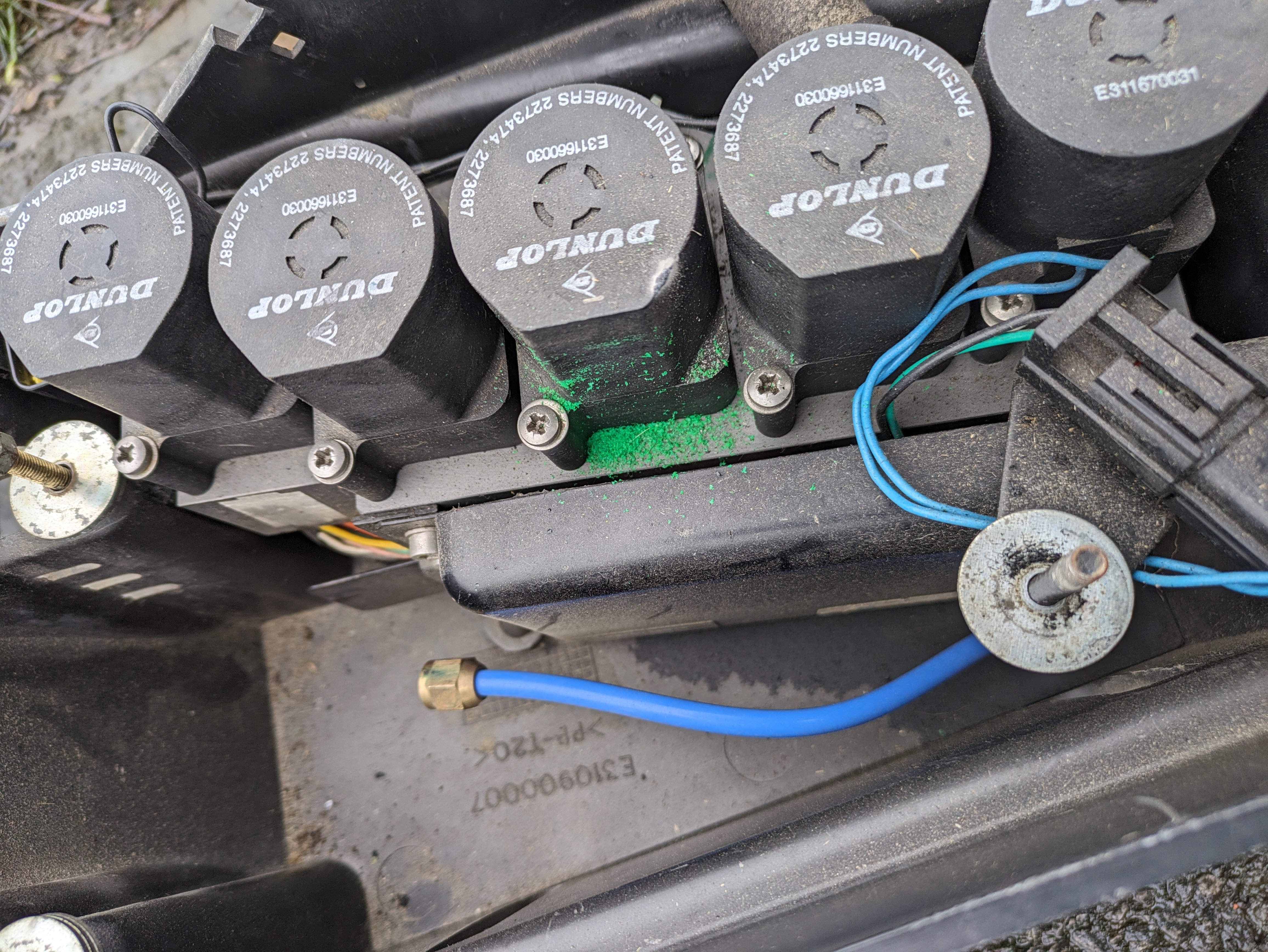

Posts: 2524
Not sure what this green powder is... can't be good?
Posts: 2524
Well, she's standing up again!
new pump, old driver pack/solenoid block. I failed to tighten the blue pipe sufficiently the first time - I wonder if that was the issue when I tried the new pump with the "new" driver/block. Hmm.
I'm goingo to leave here on standard height overnight and see what happens..
Posts: 2524
I left her in Standard overnight, and she was still drivable in the morning. It took a couple of minutes before she came up to full height.
There's something leaking, somewhere but she's driving. I have the X8R kit for the valve block sitting on the shelf. I should probably get on it.
