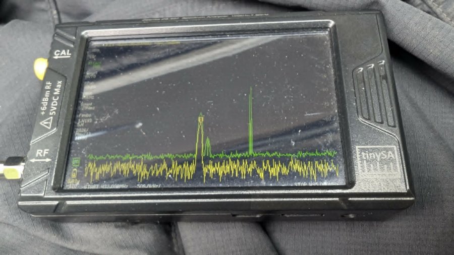

Today? Loads of stuff but not on mine. Currently in France dealing with a P38 with multiple problems. Horrendous battery drain, an intermittent instrument cluster (only works in dry weather), unable to sync the keyfobs and a diesel leak.
Decided I'd start with what I consider the easy ones. We'd already identified that the battery drain only happens when the car is parked in its normal parking place and only if the keyfob receiver is connected. If it is unplugged (completely, not just the blue wire), the battery drain is better but still not good. So the first thing I did was pull out a toy I bought myself, a portable spectrum analyser, and this is what I found.....
For those that don't understand what it shows, the yellow trace is live and shows a constant radio signal just below the frequency where the keybob operates. The green trace is a max hold so any instantaneous signals are shown by that. Just above the constant signal is a small one that popped up while I was checking, but the taller one shown on the green trace is the signal from the keyfob. So the inability to sync the fobs and the battery drain when the receiver is connected are caused by the constant one. The constant signal being there keeps the BeCM awake and I was measuring around 1.4A draw from the battery. Back in the old days when I was still working my next step would be to trace where it is coming from and get it switched off. Unfortunately I no longer have the authority to do that, particularly outside the UK.
Fitted one of Marty's fob fix filters and that did what it says it should and allowed the BeCM to go to sleep. But I still had around 0.5A being drawn from the battery.....
Went through the checks in the BeCM SID and still had 0.5A draw. As there had been problems with the instruments, unplugged them and the draw disappeared and it dropped down to 0.012A (12mA). Took the instrument cluster out and opened it up expecting to find corrosion but it looked perfect, no corrosion, nothing burnt. Put it back in and found, after the BeCM had gone to sleep again, it was back up to drawing 0.5A. then realised something. As the battery had been disconnected to stop it going flat, none of the windows were set. It was giving the message that they weren't set but there was no beeps coming from the dash. Unplugged the little speaker on the back of the cluster (with the drivers door latch tripped so it didn't detect that the door was open) and the draw immediately dropped down to 0.012A, the 12mA I had seen with the complete cluster disconnected. Checked the speaker and it was fine but with it connected, the battery drain came back. So, in consultation with the owner, decided to leave it unplugged. She also mentioned that when the dash wasn't working there was a whining noise coming from behind the dash that altered in frequency with engine revs. So it appears that something in the speaker driver circuitry is playing up but without a spare diesel instrument cluster to put in, we'll leave it as it is.
Then had a little break as it started to rain and I had noticed the HEVAC display was only showing about 3 segments. I had a couple of zebra strips in my box of P38 electrical bits, so took the HEVAC out, took it inside while it was raining and did that.
Then came the bit I wasn't looking forward to, the diesel leak. The collective wisdom of this pub had said it was most likely the leak off pipes but could be the top cover on the fuel pump. So I'd taken leak off pipe with me but after liberally spraying everything with brake cleaner to get it clean and dry, started the engine and watched as it started to leak from the top cover joint. Bugger. I don't do diesels and know very little about them but it turns out that once the inlet manifold is off, getting to the pump is reasonably simple. There's a strange headed bolt and 3 Torx headed ones but a 8mm Irwin socket took care of that. It has a seal like an O ring but not round, that had presumably lost its elasticity so wasn't sealing so I put a very thin smear of my preferred Reinzosil on it and bolted it all back together. After everything was back where it should be, I started the engine and no more diesel leak. I'd call that a result and a lot cheaper than the 2,000 Euro plus labour for fitting it the owner had been quoted for a new pump.
All that is left to do now is drive it away from this spurious radio signal and sync the fobs, but that can wait until tomorrow, there's food and copious quantities of red wine about to be served.
