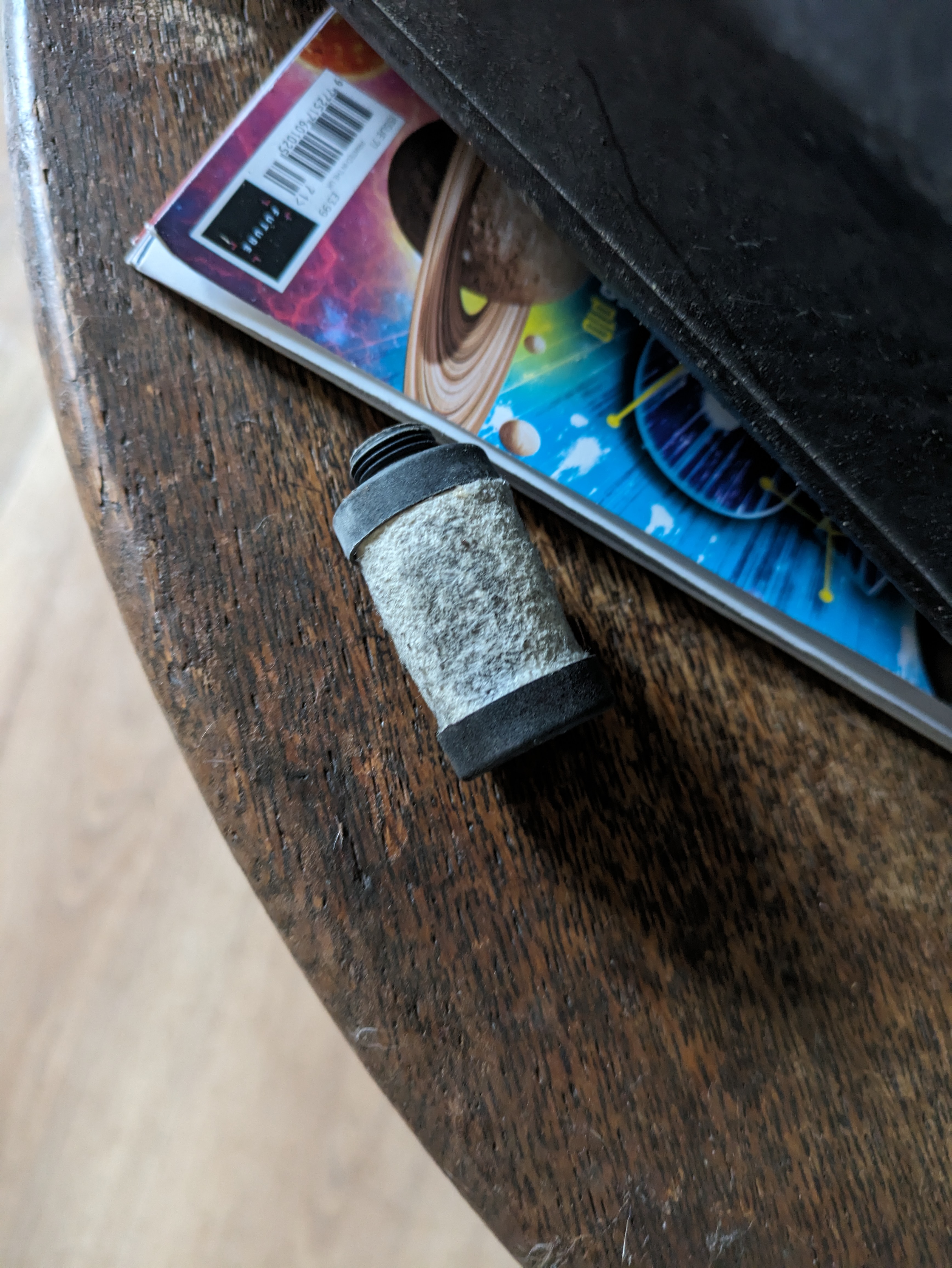

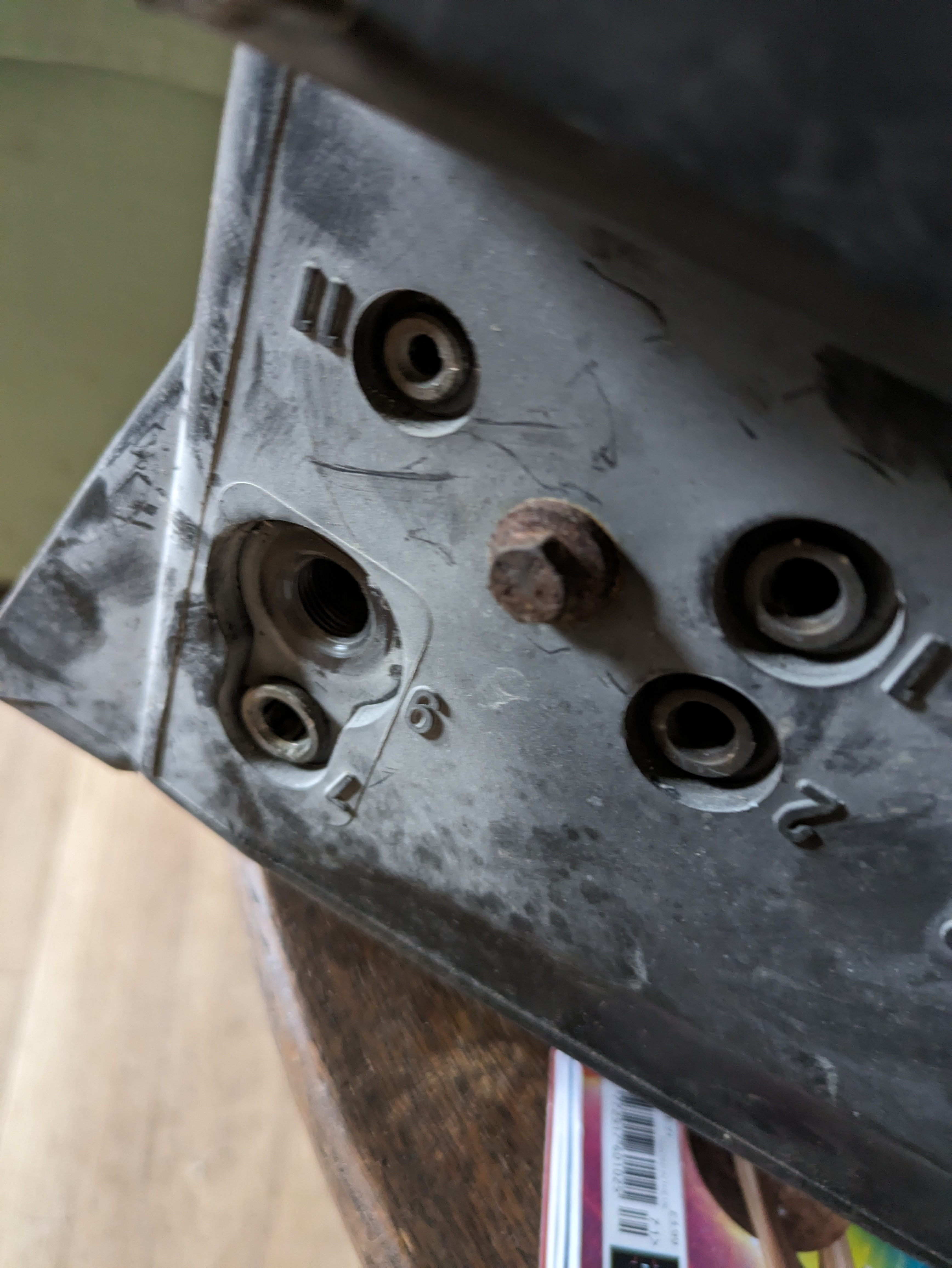

HI all,
I thought I'd get a spare set of EAS gubbins so I can rebuild and swap instead of leaving the Duchess sitting on her arse while I build motivation between steps.
So I bought a semi-dodgy looking set (non rebuilt but allegedly tested good) with the intention of swapping it in to see if it's working, then making a decision. If it doesn't work I've a decent shot at a return as it was described as working.
However, the exhaust looks to have been blowing white powder for some time. Assuming this hasn't been used by a Colombian Cartel to make deliveries, I'm guessing this is dessicant from the dryer.
Should I just rip this thing to bits now, or would it be OK to hook it up to the vehicle and see if it works in the current state? I'm slightly concerned about potentially pushing dessicant through the rest of the system.
